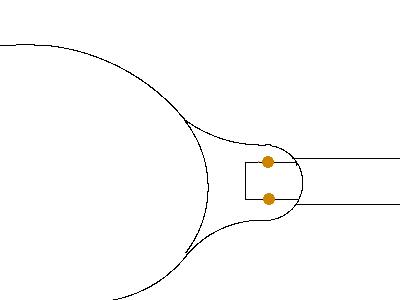

I'm working on my first carved top mandolin and things are going pretty well. It is an A2 style. The plans that I have calls for a dovetail to attach the neck. I'm not jigged up for routing a dovetail in a mandolin so I'll probably cut it by hand. In some other thread (here or elsewhere), I heard reference to "the dowel method" to attach a mandolin neck. I don't have a clear definition of this method. I once recall seeing a drawing or picture of a mandolin neck that had dowels but I don't know if that was what people are refering to when they talk about the dowel method. I've sketched out what I remember seeing. Is this what they are talking about?

That looks like the type of joint described in the Siminoff book. He makes a dovetail joint and ties the heel to the neck by putting in two dowels right where you have them in your diagram.

I thought this joint was a straight mortice and tenon. I've wondered you the neck was pulled tightly against the body. I looks like you have to set the neck and clamp or strap it in place before you drill the dowel holes. On a violin you use big rubber bands to pull the neck in. Is is similar on a mandolin?

You have it right, Mike. This is usiually a straight M&T, though tapered in the same shape as the heel. You make a jig to hold the body and neck to their proper relationship, and glue it up. Once the glue has set, drill for a 1/4" dowel on each side to lock the joint.
It's a really, really strong enck joint, and can still be dissasembled readily if the neck ever needs to come out, as long as you use hide or titebond glue.
I use this joint, still, on my mandolins. I prefer it to the dovetail, as it locks the neck more tightly, with more surface area, with less finicking in the fitting. I make mine with a slight taper, so it is also a shallow angle dovetial. Basically, I just carry the fretboard's taper up into that area, which along with the heel's taper, creates a shallow dovetail. Add dowels, and you have a joint that will never move...
